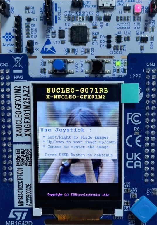

2023-07-12 5:33 PM
Hello Jiannong Zhou.
I am also testing with the NUCLEO-G071RB + X-NUCLEO-GFX01M2 ($AZ2) combination.
As you said, AZ1 and AZ2 of X-NUCLEO-GFX01M2 have different LCD and LCD Driver IC.
1. X-NUCLEO-GFX01M1
1.1 XNGFX01M1$AZ1
This product identification is based on board MB1642-DT022CTFT-B01.
The LCD used in this product is DT022CTFT with driver IC ILI9341V.
2. X-NUCLEO-GFX01M2
2.1 XNGFX01M2$AZ1
This product identification is based on board MB1642-TCXD022IB5-D01.
The LCD used in this product is TCXD022IBLON-5 with driver IC ST7789V.
2.2 XNGFX01M2$AZ2
This product identification is based on board MB1642-DT022CTFT-D01.
However, AZ2's LCD and LCD Driver IC are the same as X-NUCLEO-GFX01M1.
So, if you use the two projects in the en.X-CUBE-DISPLAY.3.0.0.zip file (example), you can create a project for AZ2.
STM32CubeIDE\en.X-CUBE-DISPLAY.3.0.0\Projects\NUCLEO-G071RB\Applications\
- GFX01M1_HelloWorld
- GFX01M2_HelloWorld
The task basically uses the GFX01M2_HelloWorld project.
1. Copy 'lcd_io.c' and 'lcd_io.h' in the 'GFX01M1_HelloWorld\DISPLAY\Target folder to the GFX01M2_HelloWorld\DISPLAY\Target' folder. (overwrite)
2. Modify the following contents in 'en.X-CUBE-DISPLAY.3.0.0\Projects\NUCLEO-G071RB\Applications\GFX01M2_HelloWorld\Core\Inc\RTE_Components.h' file.
#define DISPLAY_LCD_COMP_ST7789V -> #define DISPLAY_LCD_COMP_ILI9341
3. In the folder 'en.X-CUBE-DISPLAY.3.0.0\Projects\NUCLEO-G071RB\Applications\GFX01M2_HelloWorld\STM32CubeIDE'
Open '.cproject' and '.project' files and modify all ST7789V related paths to ILI9341 paths.
4. Open the project with STM32CubeIDE.
5. Run the build
6. If there is no error after building, select 'en.X-CUBE-DISPLAY.3.0.0\Utilities\PC_Software\ExternalLoader\MX25L6433F_GFX01M2_STM32G0.stldr' for external loaders.
Then you can run the GFX01M2_HelloWorld project in your environment.
good luck.

2024-12-21 6:36 AM
I'm trying to run GFX01M2_HelloWorld from X-CUBE-DISPLAY on a NUCLEO-G071RB with X-NUCLEO-GFX01M2($AZ2).
I understand that the supplied code does not support the $AZ2 model directly, due to it using a different controller chip from the earlier version, but the same as the GFX01M1.
Switching the chip type in CUBE-MX failed because it automatically removed the code for SPI1, which was still needed for the GFX01M2 board.
I have downloaded and unpacked the package, and imported and built the two projects GFX01M1 and GFX01M2 into CUBE 1.17.0 without errors. This loads and runs on the G071RB but as is to be expected, goes to error in initialising the display.
Following the above instructions to merge the GFX01M1 code into GFX01M2 led to the following build error:
make: *** No rule to make target '/home/puposet/Downloads/X-CUBE-DISPLAY/Drivers/BSP/Components/ILI9341/ILI9341.c', needed by 'Drivers/BSP/Components/ILI9341.o'. Stop.
I seem to be missing something. Is there another step I need to do?
2024-12-21 12:23 PM
Let my brain stew long enough and it answers the question itself.
It's case sensitive. The search-and-replace text in step 2 should be ili9341 not ILI9341.
That done, it now works. Onward!
