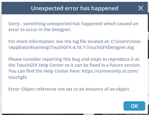

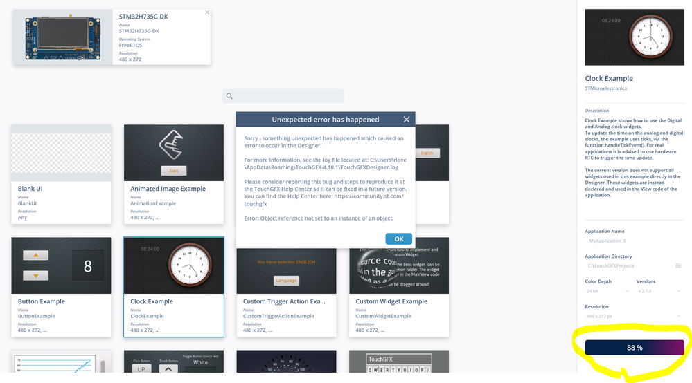

When I generated example of GFX designer, unexpected error has happend.
TouchGFX Designer-4.18.1 stopped at 88%I already tried to uninstall and reinstall but without success.
And the TouchGFXDesigner.log as follows.

2022-02-09 13:12:38,351 [1] ERROR TouchGFXDesigner.App: Object reference not set to an instance of an object.
System.NullReferenceException: Object reference not set to an instance of an object.

2022-02-09 2:18 AM
Hi rloveusm,
Seems that you don't got the permission to write in your TMP folder (C:/Users/rlove/AppData/Local/Temp).
Can you please check your rights permissions on that folder ?
Otherwise, if it still doesn't work, please try to run TouchGFXDesigner as an administrator.
/Yoann
