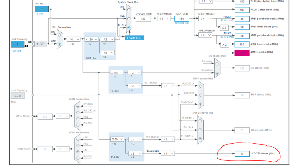

cd00278141-qvga-tftlcd-direct-drive-using-the-stm32f10xx-fsmc-peripheral-stmicroelectronics.pdf saying there's a tim3 clock used for adjusting the frame rate of the display. So i try to find any corresponding timer that may be used for refreshing the display, the only one i found is in clock configuration. If this is the part to modify the frame refresh, how can i calculate required frequency for my target fps

Hi. Yeah, change the pixel clock until you have the desired vsync frequency (You may also want to change porch timings). e.g. 16,66 ms = 60Hz
This will give you a maximum framerate, relative to that frequency. You'll most likely always have that framerate because of your simple application.

The touchgfx render time is tied closely to the VSYNC of the display. For simple applications, 16ms (60hz update) is achievable. By lowering the pixelclock you can measure the vsync/render-time for your concrete application through signals exposed by TouchGFX. Lowering the pixelclock (highlighted in your image) is one way to achieve a lower update frequency and thus a lower, possible framerate.

If I understood correctly, I need to adjust the LCD- TFT clock to reduce the FPS to desired value, and simultaneously use a scope to monitor my configured gpio associated with the FRAME_RATE?
