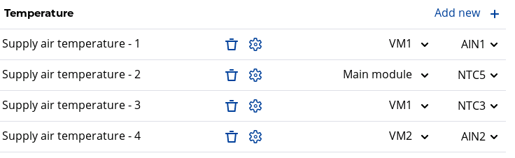

I'm faced with problem when I add elements to list. For better understanding I explain what I want to do. So here when I click add new elements I go to other screen where config pinout. And when I click save it stores names like "VM1", "Main module" in array there is placed in model.hpp. In list layout I can create 5 elements.When I add more than 3 elements to the list my names somehow which I store in array disappear and random values which is in my project enrolls
What can cause this problem?

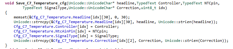

This is how put information in to arrays

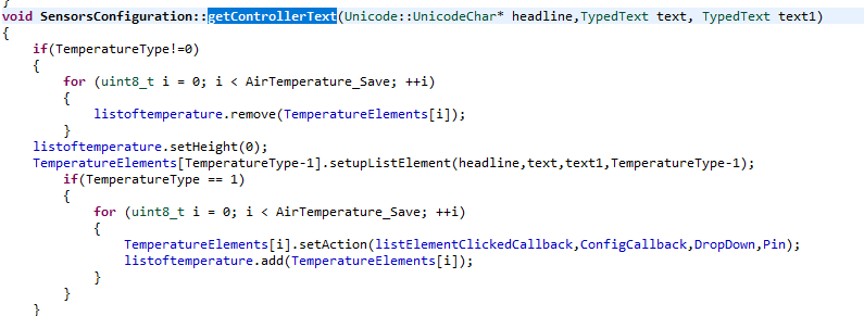

Here adding elements to list :

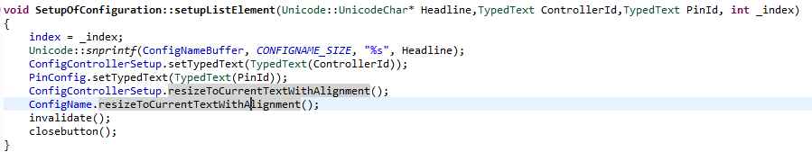

And this is how create list members:

May I ask what is this line supposed to do ?
memset ( & Cfg_C7_temperature.Headline[idx][30] , 0, 30 );If intention is to clear the string at index 'idx' then this is correct statement
memset ( Cfg_C7_temperature.Headline[idx] , 0, sizeof (Unicode::UnicodeChar)*30 );
2023-01-26 10:39 PM
Nope, this is not working for me as you said.
