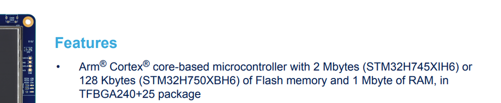

In your question miss important info what mcu on your disco? 128k version is more difficult...
but primary code for new display is more better start with right steps new project as convert existed projects.
2023-05-15 12:53 AM
Hi, the board has STM32H745XIH6, so it's 2Mbytes and not 128KB.
