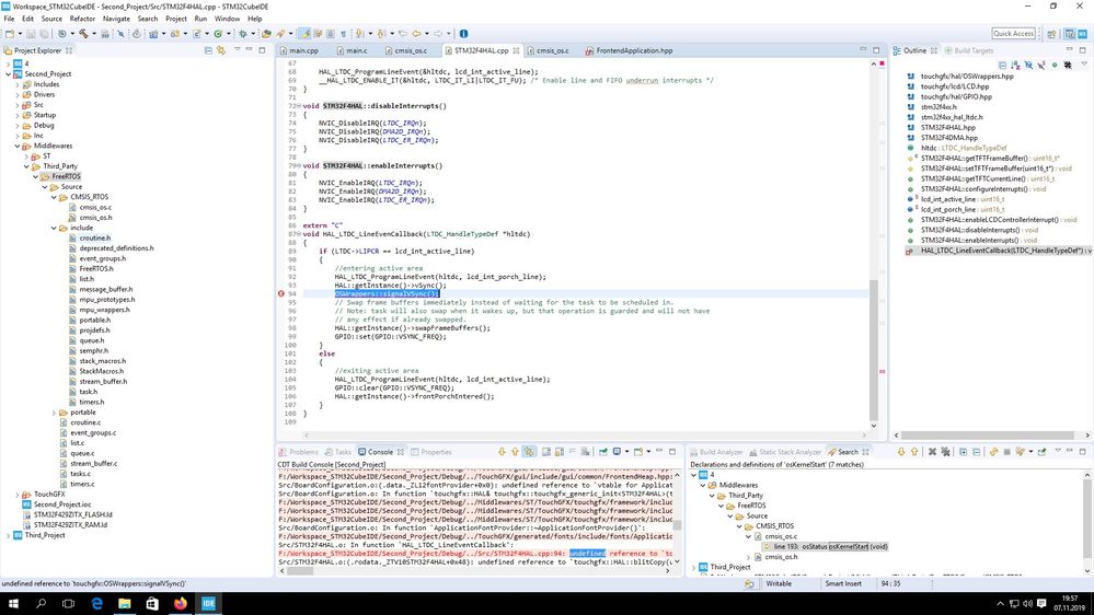

2019-11-07 10:01 AM
Second problem has been already solved :):):)
ALL FreeRTOS file there are (see attached file)
2019-11-07 11:45 PM

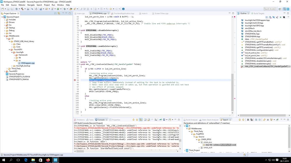

Can you find OSWrappers.cpp in your project? That's where the missing symbol is coming from.
/Martin
2019-11-08 5:46 AM
Yes. There is
2019-11-08 6:09 AM
Is your project set to compile C++ or just C ? Seems like there are a lot of symbols from cpp files missing.
/Martin
2019-11-08 6:22 AM
Target language was set to C++.
