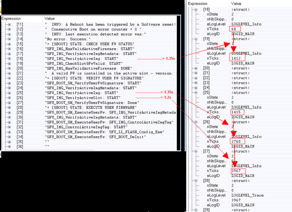

I have added an image in attachment showing where the time is mainly spend with the current timings (1 tick = 1ms ).
I don't think I see much of the ECDSA time you are refering to. I only see significant time spend in the 2 functions i just mentioned, one of them being an SHA256 calculation over the firmware (VerifyActiveImage) and one checking the region after the firmware for no spurious code (VerifyActiveSlot). This is if I understand what these functions are doing correctly.

Edit: there is something really fishy going on with my tick measurements. Now it says the tick count is around 1400 by the time the application launces, but if I chrono it it is more +- 7 seconds. I checked if I just add a 10s delay and print something before/after on the uart and that delay is indeed 10s with the tick counter increased to 10000 so basic tick timing is ok. Maybe ticks are not counted (irq disabled) during some parts ?

Ok so I looked with the scope and some prints
SFU_IMG_VerifyActiveImgMetadata: Start
[383ms]
SFU_IMG_VerifyActiveImg: Start
[4343ms]
SFU_IMG_HasValidActiveFirmware: Done
[383ms]
[387ms]
[388ms]
SFU_IMG_ControlActiveImgTag: Start
Seems like ticks (interrupts?) are indeed disabled for long periods during these calculations
