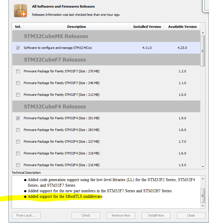

2017-10-25 1:40 AM
@all:
The latest release of STM32CubeMX (v4.23) support mbedTLS middleware now!
2017-11-12 11:06 AM
hi,
sorry, the v4.23 is intended to support only the mbedtls without hw crypto.
the hw crypto integration is currently under study
keep you updated!
