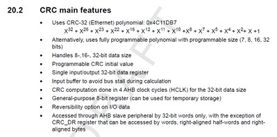

The CRC algorithm implemented in the CRC hardware IP (see CRC chapter 20 of the Reference Manual) is CRC-32 (Ethernet) polynomial: 0x4C11DB7

Thanks, yes it is the algorithm used by all the STM32 Families, however it is a hardware accelerated algorithm.
I confirm, we can emulate the CRC behavior using your shared code.
For more information about the CRC peripheral can be found in AN4187 (Using the CRC peripheral on STM32 microcontrollers - Application note
