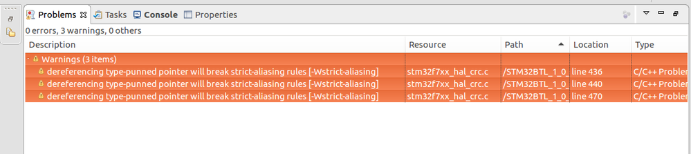

We have designed a custom board with STM32F777IITx MCU on it, where i am using ST Micro's CubeMX with Atollic True Studio for developing the code.
Now I am also using a USB host peripheral and reading data from USB device now this data read from USB needs to checked for CRC.
I tried to build a basic code using ST Micro's CubeMX and Atollic True Studio which would calculate CRC of an array,
However when build the Code i am getting the given below warnings and also if i ignore these warnings my code gets stuck after it executes "HAL_CRC_Calculate" api.
de-referencing type-punned pointer will break strict-aliasing rules [-Wstrict-aliasing]
The given above warnings also come when in blank code generated using Cube MX.
Also i referred the example code "CRC_Example" from the "STM32Cube_FW_F7_V1.9.0" Firmware package.(This example was for boards "STM32F769I_EVAL" and "STM32F769I-Discovery").
After referring example code from firmware package and incorporating the changes as per the example code in blank code yet i am getting same warnings.
2019-11-27 10:26 PM
This is consequence of a "hardware hack", where the data register of CRC behaves differently when written as byte, halfword or word. The offending line(s) are:
pReg = (__IO uint16_t *)(__IO void *)(&hcrc->Instance->DR); /* Derogation MisraC2012 R.11.5 */
Unfortunately, the C programming language has no "correct" way to tell the compiler that "this is a very special register, it's OK to access it in several different ways", this is why the compiler rightfully warns.
So, you either ignore this warning (suppress it selectively when compiling given file), or reimplement the function so that there are no such offending type punnings (punning to byte appears to be OK from gcc's point of view).
