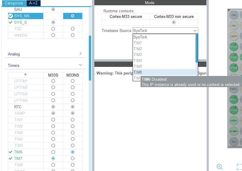

Hi, I've created a project in STM32CubeIDE 1.14.1 for the Discovery board B-U585I-IOT02A with TrustZone enabled. Unfortunately, I'm unable to select any of the TIM timers as the SYS_NS and SYS time source. They are disabled with the following message: "TIM6 disabled: This IP instance is already used or no context is selected."
However, I activated the TIM6 timer with a Non-secure context enabled.
Thanks in advance for your help!

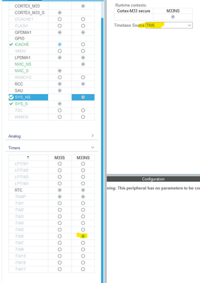

Hello @SedCore ,
you need to assign the TIM6 to the NS world in timers to be able to select it as timebase.
Here is a screenshot illustrating this:

2024-05-20 11:20 AM
@STea thanks for your rapid response. But as you can see on the screenshot that I provided, TIM6 is already assigned to M33NS, but it is grayed out when I try to select it as a Timebase Source for SYS_NS, with the following error being displayed: "TIM6 disabled: This IP instance is already used or no context is selected."
