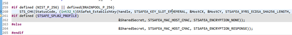

I have successfully run the Establish_Secret demo project, it shows ephemeral key usage:

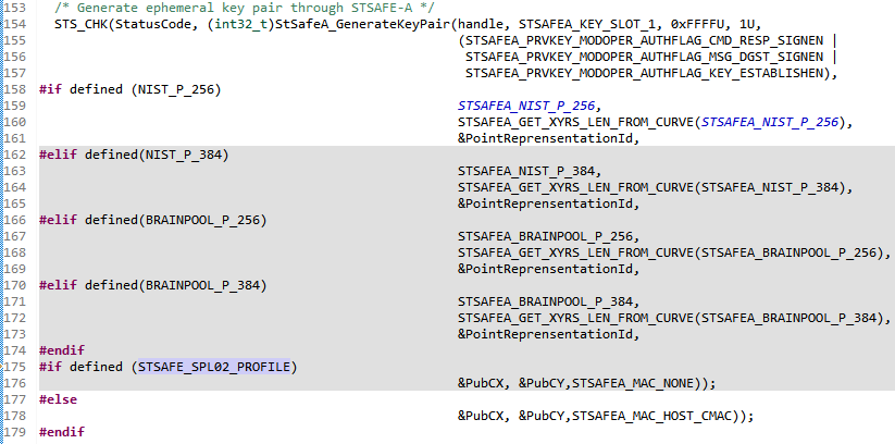

As I need the TPM's private key to survive the power cycle, I replace the ephemeral slot with the static slot 1, also on StSafeA_GenerateKeyPair call:

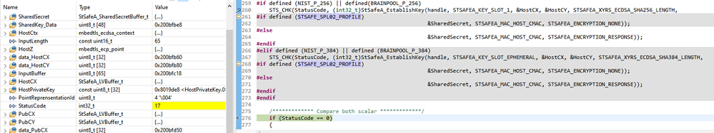

The call to StSafeA_EstablishKey then fails with code 17 (STSAFEA_UNSATISFIED_ACCESS_CONDITION):

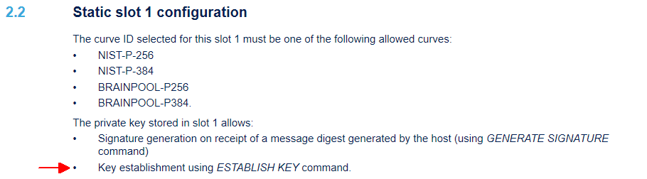

Why does it fail? The documentation for STSAFE A110 clearly states that this feature is supported for slot 1 (document dm00675324):
