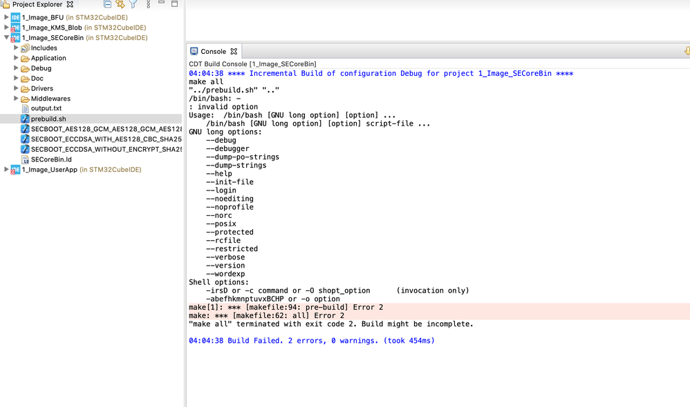

I am working on a project using STM32Cube_FW_WL_V1.0.0.
I cannot compile the 1_Image_SECoreBin project included in the BFU_1_Image sample project.
I am using STM32CubeIde on macOS Catalina.

2021-05-04 10:55 AM
About bash option in Catalina this is quite strange as bash is supposed to be standard. I can't tell ...

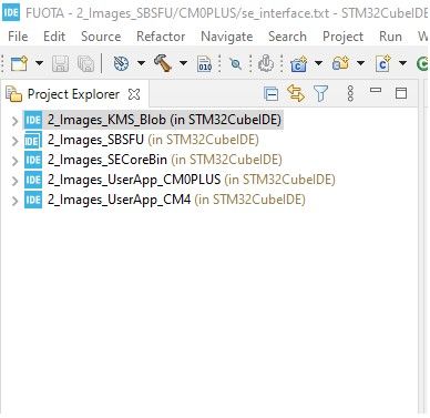

2021-04-26 3:26 PM
Hi there,
I also tried on Windows 10.
I installed necessary tool chain for STM32CubeMXIde.
Then I prepared SBSFU_2_Images_DualCore sample project
I'm sure that, compiling the correct order according to Getting started with the SBSFU of STM32CubeWL (UM2767)
Compile order is;
The error is multiple definition error .

2021-05-08 1:21 PM
Thank you Jocelyn,
The problem was caused by the macos. Catalina version uses default zsh instead of bash.
As a solution for those who encounter a similar problem: https://www.howtogeek.com/444596/how-to-change-the-default-shell-to-bash-in-macos-catalina/
