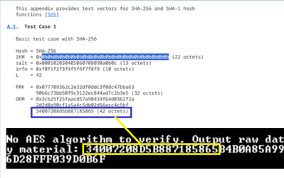

I am taking the reference implementation of the HKDF Algorithm using PSA API in the TFM Application Project and using the following algorithm :
PSA_ALG_HKDF(PSA_ALG_SHA_256);
I m able to export the output key to the console and am getting an output for the test vectors taken from RFC5869 as shown below:
But when using the same Hash, IKM, Salt, Info as given in the test vector set Im getting a different value as shown in the below format:(value displayed Derived Key Material is expected to be same as OKM in above Figure)
The codes i have used the same format that was already present to be specific:

Hi @PJose.4
I can see that the first digits of your outputs are the same as the OKM last digits
What is the status returned by the psa_key_derivation_test() API, did you see any of the output failing messages
"Failed to input salt " or " .... key" or ".... Info"
Can you give more details, how you configured the RFC5869 test vector before calling psa_key_derivation_test() ?

2024-04-02 5:30 AM
Hi @CMYL
Greetings
Thanks for your reply
While testing the function im not getting any fail message at any of the steps.
i have given the RFC Test vectors as array types as shown below:
uint8_t key_deriv_secret[22] = {0x0b,0x0b,0x0b,0x0b,0x0b,0x0b,0x0b,0x0b,0x0b,0x0b,0x0b
,0x0b,0x0b,0x0b,0x0b,0x0b,0x0b,0x0b,0x0b,0x0b,0x0b,0x0b};
uint8_t key_deriv_seed_salt[13] =
{0x00,0x01,0x02,0x03,0x04,0x05,0x06,0x07,0x08,0x09,0x0a,0x0b,0x0c};
uint8_t key_deriv_label_info[10] = {0xf0,0xf1,0xf2,0xf3,0xf4,0xf5,0xf6,0xf7,0xf8,0xf9};
The functionalities implemented has not been changed. The hash algorithm used is
psa_algorithm_t deriv_alg = PSA_ALG_HKDF(PSA_ALG_SHA_256);Attaching the code of the function for your reference
