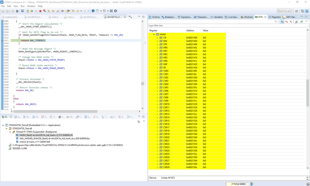

I have two different batches of Revision V STM32H750VBT6. All units in one of the batches (Date Code 045) has issue with the hash peripheral while the one (Date Code 928) is working completely fine.

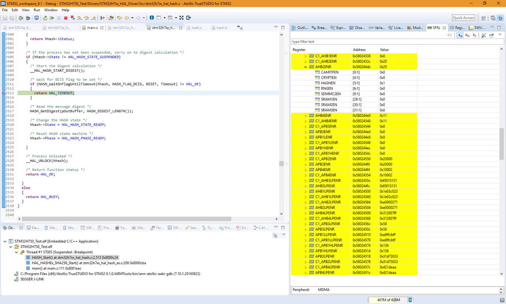

I created a new basic project for testing this issue and the code is as shown. However, HAL_HASHEx_SHA256_Start() always ended up returning HAL_TIMEOUT. Based on the SFR register view in Atollic TrueSTUDIO, all the registers for hash peripheral remains at value 0x0.

How confident are you in the source of these parts?
Looks like the unit is not enabled.

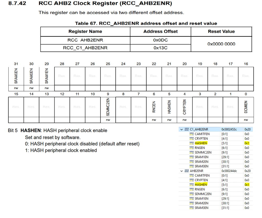

Yup it indeed looks that the peripheral is not enabled properly.
MX_HASH_Init() is called for enabling and initializing the peripheral before calling HAL_HASHEx_SHA256_Start();
