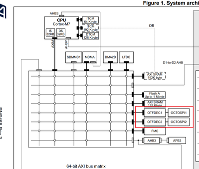

There is no mechanism to protect the external Flash for this device. Meanwhile, STM32H723/733 devices feature
OTFDEC (On-The-Fly decryption engine) for OCTOSPI memories which allows to decrypt on-the-fly AXI traffic based on the read request address information.
You can refer to RM0468 / Section 42 On-The-Fly decryption engine - AXI (OTFDEC)

The content can be encrypted at rest, and you can move to RAM to execute, or pick the H7xx parts with 2MB of internal FLASH on die that's tested.
There are other parts in the H7 family supporting OCTOSPI, and encryption-on-the-fly, to protect/obfuscate the content of the external memory.
