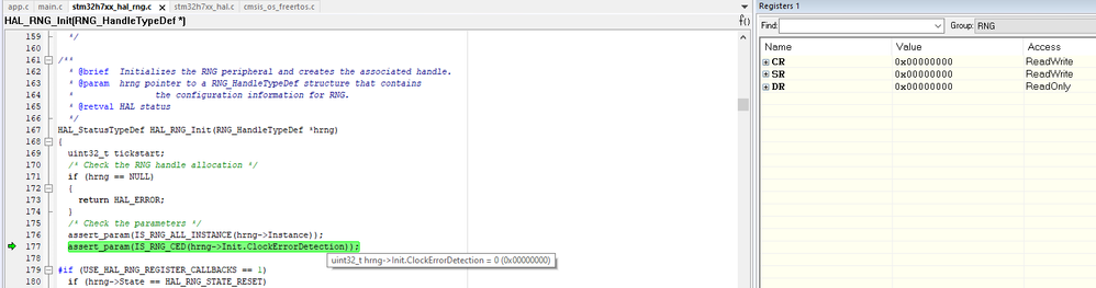

I am using the code genereted by cubemx:
int main(void)
HAL_Init() ;
SystemClock_Config() ;
PeriphCommonClock_Config() ;
MX_RNG_Init() ;
I think that pll and clock are running

Beginning:

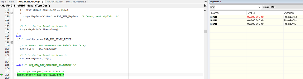

after msp init:

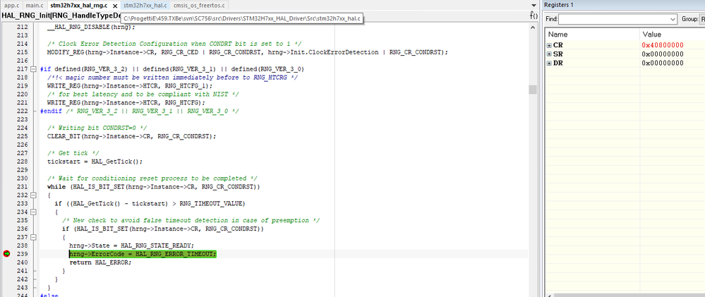

here the error:
