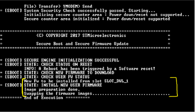

Taking another look at the output, I now think the board is properly rejecting the image with the corrupted header, but an error message specific to that case isn't being displayed. When I load a valid FW image, I get this message saying the new FW needs to be installed, and then it is swapped into the active slot:

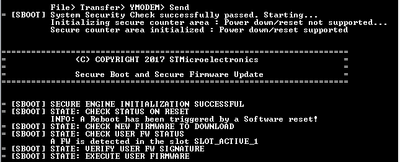

However, when I try to load the image with the corrupted header (any single bit flipped before byte 1024), I get this message that does not contain any lines indicating the image is being installed or swapped:
It seems that in this second case, the SBSFU detects the corrupted header and rejects it, but does not output a message about the header being invalid. It then goes on to execute the existing valid FW in the active slot. Is my interpretation correct? And would you expect there to be a message about the header or no?

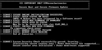

I expected there to be an error message about the header because when I corrupt the firmware image past the header (byte 1024) and try to load it I get a "Fw signature check error" message, and then the already loaded and valid program is executed:
