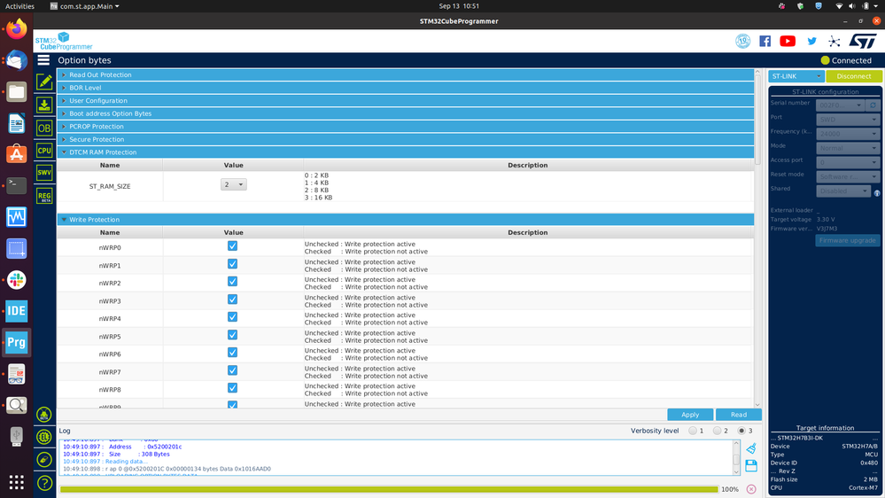

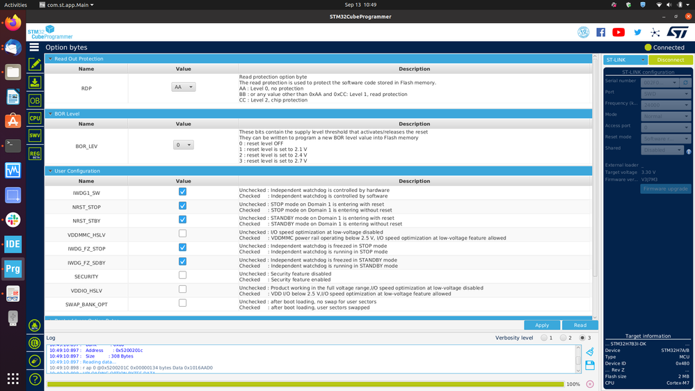

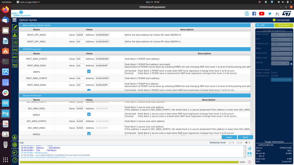

the stm32programmer can connect, erase whole chip, but cannot program.
What I have done is to run example of SBSFU example (1 Image). I can see bootloader running. Then I try to erase the chip to program my other program.
I try to load the PCROP and secure section from my coworker's setting, but it does not allow me to change.
I attached all the stm32programmer logs.
May I know anyway can solve this lock program, or this device is actually locked

Hello @jiangpen
your option bytes have definitely not the good value.
Here is what you should get:
