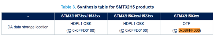

The key is written to h503 in the OTP memory, at the address 0x08FFF000 (specify this address in DA_ConfigWithPassword.xml in the file in the <ObDestAddress> field when preparing the password), so it must be clean and never written before.

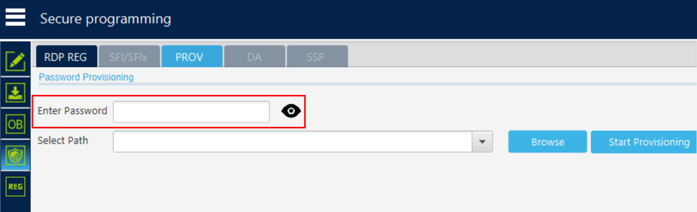

Do I understand correctly that for the protection level to work correctly, a clean, unwritten OTP memory is required? I have already tested OTP recording on this processor, could this interfere?
I also do not understand the password entry field in the cube programmer, are the password field and the .obk file selection field mutually exclusive?

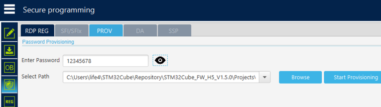

then in the Cube Programmer, PROV tab, in the Enter Password field, you enter your password, and in the Select Path field, specify the path where the generated OBK file is located and click Start Provisioning.

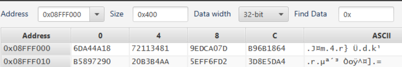

You can program a password into the processor in the ED or 17 state, it makes no difference. After programming, you can view the encrypted password at 0x08FFF000.

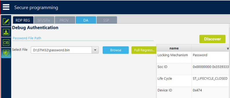

Removing protection (transition to the open state == ED)
1- the processor reset pin MUST be connected to the RESET stlink pin, otherwise you will not be able to remove the protection.
2- without pressing connect, go to the Secure Programming tab, open the DA tab, press the Disk button there and a description of the state of your processor and its ID will appear.
3- press Full regression
4- done, you have set the password, set and removed the protection.
