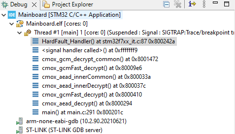

But only with changing SysTick to Tim1 and NOT enabling FreeRtos I get a HardFault calling the crypto function like (cmox_aead_decrypt).
retval = cmox_aead_decrypt(CMOX_AES_GCM_DEC_ALGO, /* Use AES GCM algorithm */ message_rx.payload.ciphertext, sizeof(msg_tag), /* Ciphertext + tag to decrypt and verify */ sizeof(Expected_Tag), /* Authentication tag size */ Key, sizeof(Key), /* AES key to use */ IV, sizeof(IV), /* Initialization vector */ NULL, 0, /* Additional authenticated data */ decrypted_msg, &computed_size); /* Data buffer to receive generated plaintext */
