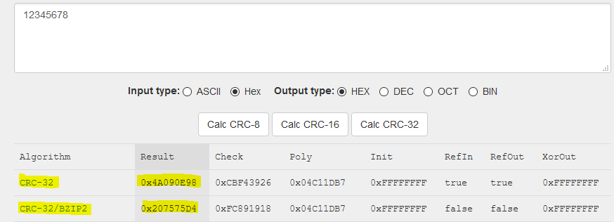

I did some testing with the FM3 uC. I changed the CRC Input Byteorder from little endian to big endian and I received this crc value:
0x4A090E98
On the STM uC I did an XOR calculation the the result value:
0xDF8A8A2B^0xFFFFFFFF = 0x207575D4
Then I check these two values with an online CRC calculator (https://crccalc.com)
But I have no Idea what the difference between these two calculations are.
Is there a way to get from one to the other value with a calculation?
