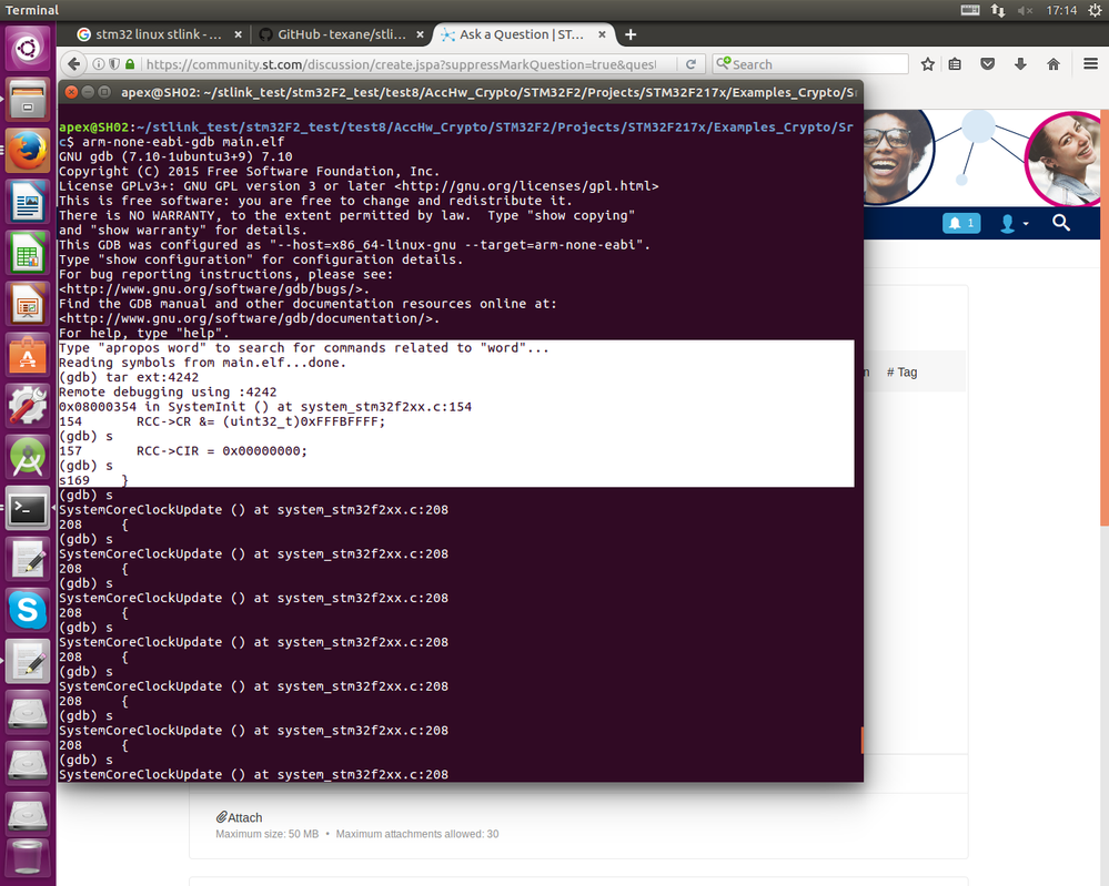

Type ''apropos word'' to search for commands related to ''word''...
Reading symbols from main.elf...done.(gdb) tar ext:4242Remote debugging using :42420x08000354 in SystemInit () at system_stm32f2xx.c:154154 RCC->CR &= (uint32_t)0xFFFBFFFF;(gdb) s157 RCC->CIR = 0x00000000;(gdb) ss169 }I was wonder why it don't start @ main.c
Anything i would come wrong?

2017-01-17 5:33 AM
In the CMSIS model startup_stm32f4xx.s calls SystemInit() prior to initialize the statics so you can setup the clocks, processor (FPU, VTOR, etc) and external memory interfaces.
It can stick in SystemInit() and called code if the clocks or PLL don't start properly.
You should review that code to understand why it can't finish and get back to main()
