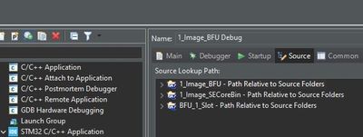

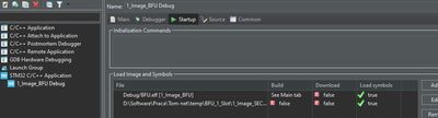

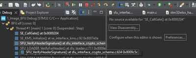

2024-05-15 2:27 AM
I've added SECoreBin symbols in my debug configuration. When I debug function 'SE_CallGate' from SE, debbuger displays error "no source available for SE_CallGate() ...". I think that everything is ok in debug configuration. I must yet set something else? Debug/Source? Screens below:
