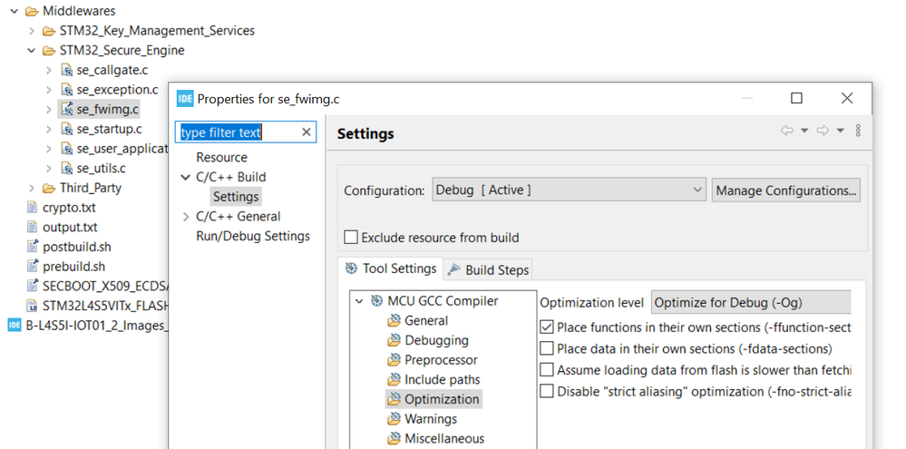

1) Change compiler option for se_fwimg.c
2) Rebuild SECoreBin Project

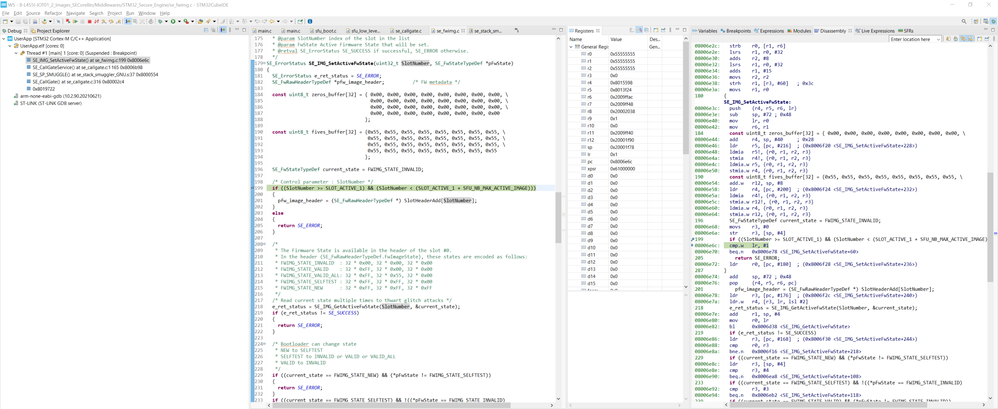

I did a fresh install of CubeIDE 1.8.0 and SBSFU 2.6.0 builds without problems. So I tried debugging the default userapp and could not get that to work (the debugger simply exited after starting mentioning Break at address "0xfffffffe" with no debug information available, or outside of program code).
However I did manage to get the debugger running for my own app, and I did get it to break in SE_IMG_GetActiveFwState() but within that function is breaks at points were there are no break points and jumps seemingly randomly through the lines.

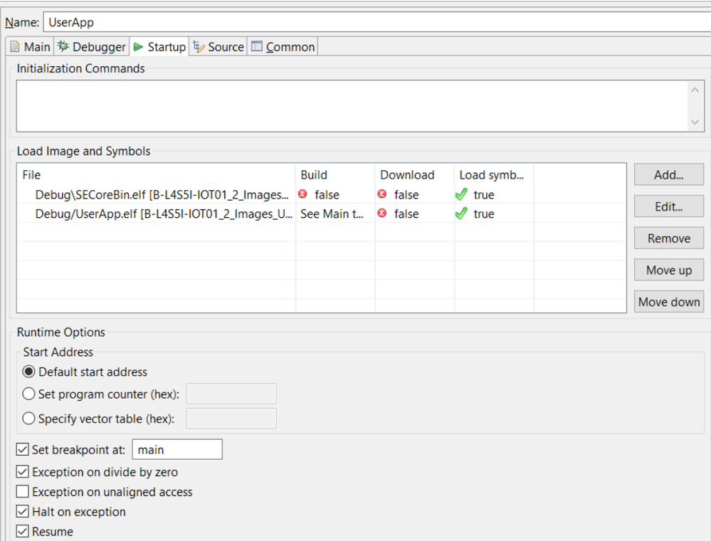

Regarding debug configuration. You added SBSFU in the picture.
To make things work with also SBSFU, the SECoreBin.elf should be in first place.
