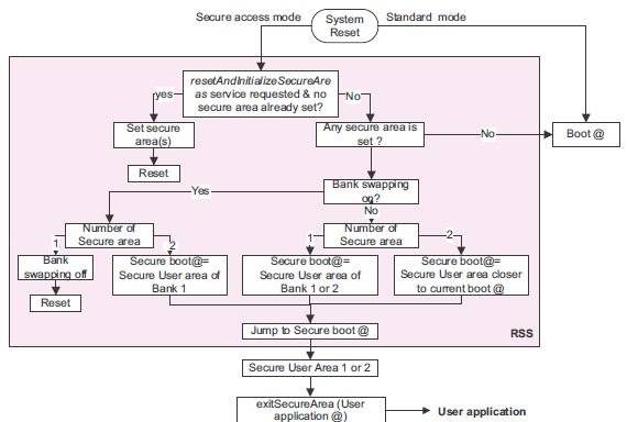

just note that H7 implementation of SBSFU uses the secure user memory. When only one user secure memory is set, boot is automatically set to this area, whatever the swap bank bit value.
here is the sate machine for H7 series boot: using SBSFU :
check UM2262 section 5.3 for more details.
Regards

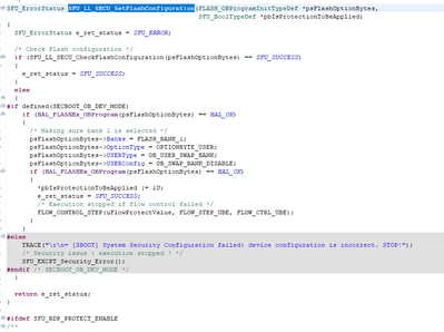

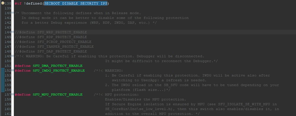

The code disabling the SWAP is always ran except if you uncomment this line in app_sfu.h file #define SECBOOT_DISABLE_SECURITY_IPS
I commented the protections which you have shown and flash my SBFU code and the SWAP BANK is showing disabled after I started it with it enabled. This is right as code goes into the SFU_LL_SECU_SetFlashConfiguration which disables the SWAP BANK
