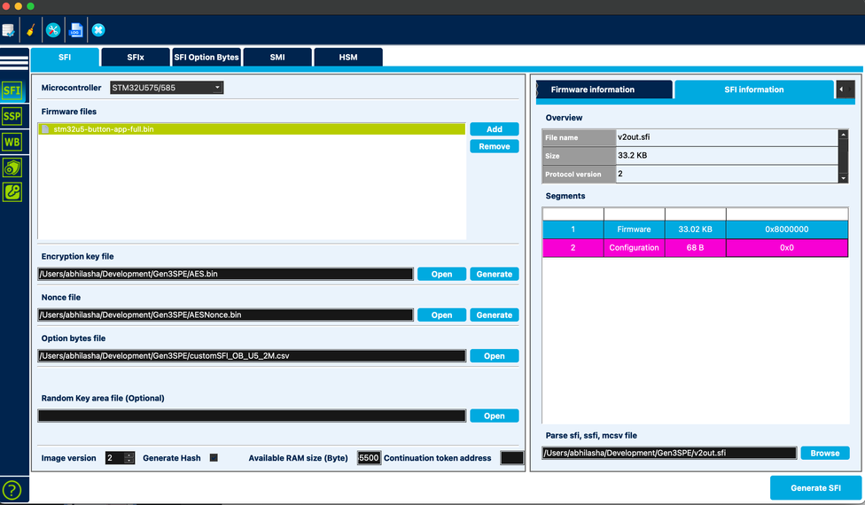

I generated an SFI image for STM32U585 based on my application. here is the details:
Firmware information:
SFI image details:
However, when I try to install this image, it fails with the error:

- The license part looks ok to me.
I am not able to determine if there is an issue with my firmware image or the way I am generating my image.
Any help would be appreciated. Thanks!

It seems like the error occurs while processing the second area which contains the Option Bytes to set.
The Option Bytes template file for U5-2M RSSe SFI v4.0.0 is as below:
OPTR,0x9DA9F955
NSBOOTADD0R,0x0800007F
NSBOOTADD1R,0x0BF9007F
SECBOOTADD0R,0x0C00007C
SECWM1R1,0xFFFFFF80
SECWM1R2,0x7F807F80
WRP1AR,0xFF80FFFF
WRP1BR,0xFF80FFFF
SECWM2R1,0xFF80FFFF
SECWM2R2,0x7F807F80
WRP2AR,0xFF80FFFF
WRP2BR,0xFF80FFFF
KEYSDIVERS,0x00000000
OEM1KEYR1,0x00000000
OEM1KEYR2,0x00000000
OEM2KEYR1,0x00000000
OEM2KEYR2,0x00000000
Is the format different from the one you used when creating your SFI image?

Here it is in plain text:
main$ cat customSFI_OB_U5_2M.csv
OPTR,0x9DA9F9AA
SECWM1R1,0xFFFFFF80
SECWM1R2,0x7F807F80
WRP1AR,0xFF80FFFF
WRP1BR,0xFF80FFFF
SECWM2R1,0xFF80FFFF
SECWM2R2,0x7F807F80
WRP2AR,0xFF80FFFF
WRP2BR,0xFF80FFFF
2025-01-22 10:00 AM
I think the issue comes from the RDP value in OPTR register. The minimum RDP value that can be set for a SFI is 0.5 (0x55) because the goal of the SFI procedure is to protect the user's firmware from the contract manufacturer.
After a SFI procedure, the contract manufacturer shouldn't be able to access the user's assets, so the RDP level must be higher than 0 (RDP 0 opens Secure and Non Secure debug).
You can find more information on this in the Application Note AN4992 :
AN4992
Best regards,
Tanguy
