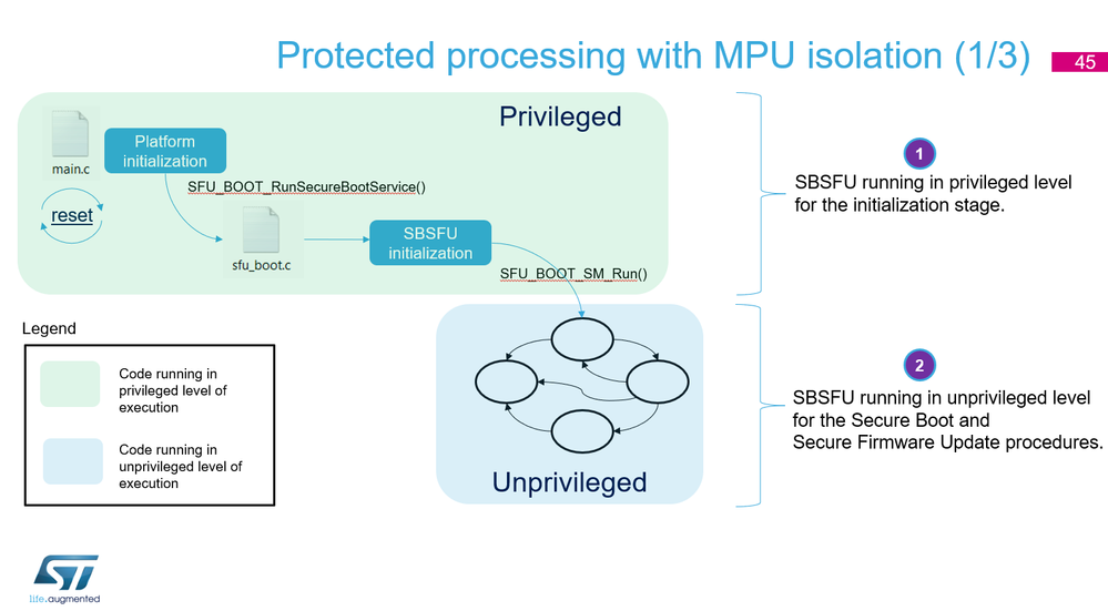

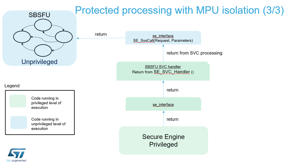

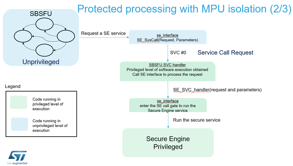

The mechanism is indeed to split the system in 2 parts:
Secure Engine is "only" a way to put in place this isolation with a unique entry point.
You can implement this without Secure Engine, right.
Please note that this means that you need your applicative code to run in unprivileged mode by default : this can be tricky too.
The principle is this one:
