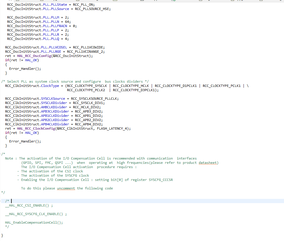

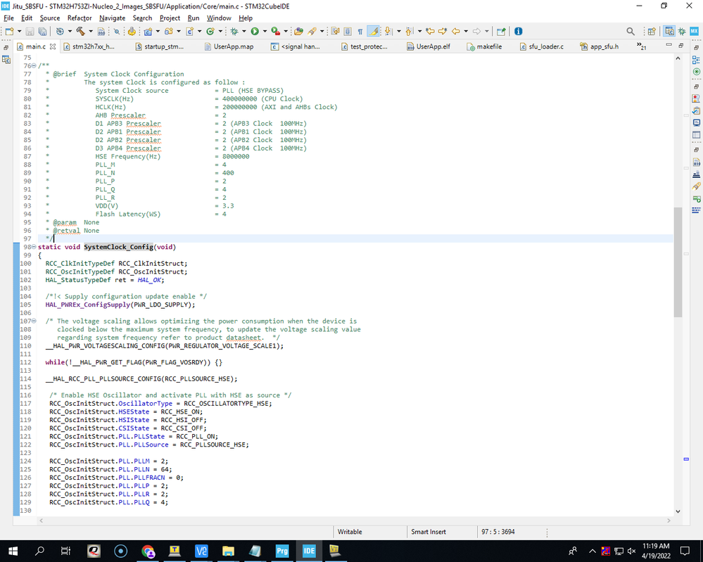

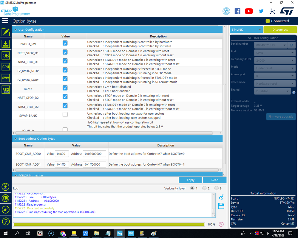

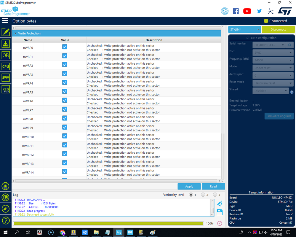

2022-04-19 1:03 AM
I am starting implementing SBSFU (Secure Boot and Secure Firmware Update) in my Nucleo STM32H743ZI Board. I have STM32CubeExpansion_SBSFU_v2.6.0. I am taking Reference for Nucleo STM32H753ZI MCU with 2_Images example.
=> After Debug STM32H753ZI-Nucleo_2_Images_UserApp in the STM32H743ZI board, for the very first time Green LED blinks and code run in FW_APP_Run(); infinity loop but it does not show Log properly in Tera term I will attach Images for reference. Once I will Push Reset button or unplug and plug ST-Link (USB) then it goes in location 0xfffffffe as shown below.
Thread #1 [main] 1 [core: 0] (Suspended : Signal : SIGTRAP:Trace/breakpoint trap)
0xfffffffe
<signal handler called>() at 0xfffffff9
@Jocelyn RICARD
2022-04-19 1:34 AM
1. For the clock configuration, I recommend using CubeMX.
You can create a basic CubeMX project just to generate the clock as per your clock tree configuration.
Then you generate the oce and copy/paste only the clock configuration function form the generated CubeMX project to X-CUBE-SBSFU projects.
If you are not familiar with STM32CubeMX then you can follow this quick tutorial:
STM32StepByStep:Step2 Blink LED - stm32mcu
2. For the option bytes, you can refer to section 8.1 in this UM:
Getting started with the X-CUBE-SBSFU STM32Cube Expansion Package - User manual
It is not perfect but it gives a reference.
Then, if something goes wrong it should be captured by the SBSFU project when checking the option bytes at startup.
