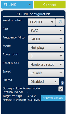

i booted the board from Rss(Boot0 pin =1) and referred to the document(AN5347) and followed the steps mentioned to deactivate the TZEN by providing separate power supply to the device and then rdp regression from level DC to Level AA and TZEN bit disable at the same time. That option byte was successfully removed. but still i am unable to do a flash mass erase the message displayed is "veriify write protection"(screenshot for the same is shown in the previous post).
Is the board permanently locked that cannot be reverted back(iam sure rdp regression was never given to level 2 and we hadnt enabled the wrp lock bits). i tried programming the unlock sequence to the wrp pins but still its the same result.
iam kind of stuck now.
Following is my option byte configuration. please have a look
