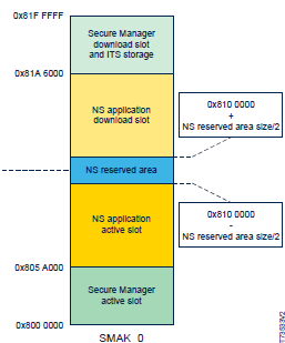

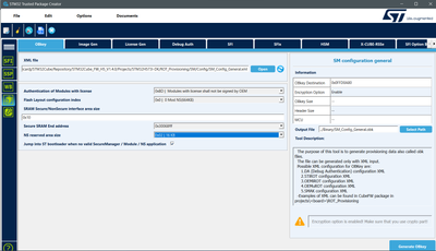

In the secure manager configuration, you have this NS reserved area that is made for this purpose. Here below an example where I setup 16KB (2 flash sectors).
These sectors are actually located at end of flash bank1, beginning of flash bank 2.
You can find the details in UM3254 Rev5 chapter 7: Flash memory mapping:
So, are you using this NS reserved area ?

All is right now. All I had to do was to declare my NS reserved area, as you suggested. It just did not seem to work because I was doing it in the wrong project ! Sorry for the confusion.
Thank you again
