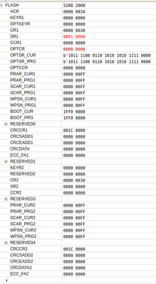

i am trying to enable the secure user memory on the stm32h743 using the x-cube-sbsfu project and have the following problem:
After activating the security bit, the value of the OPTSR_PRG flash register is not changing, so the security bit is not set and therefore i cannot configure the secure user memory.
I use the function SFU_LL_SECU_SetProtectionSecUser from the sfu_low_level_security.c file for the configuration and before calling the function i also called HAL_FLASH_Unlock() and HAL_FLASH_OB_Unlock().
Does anyone know what could be the problem?

And after calling HAL_FLASH_OB_Launch(); the SECURITY Bit in OPTSR_PRG is not set
