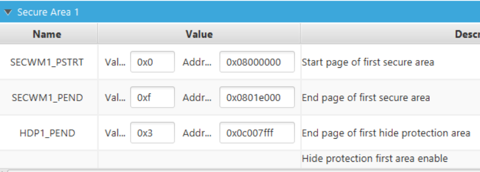

I have configured HDP as follows :
By Bootloader .icf details are :
define symbol __ICFEDIT_region_ROM_start__ = 0x0C000800;
define symbol __ICFEDIT_region_ROM_end__ = 0x0C007FFF;
Configurations when i debug the code are also fine :
Now from Bootloader i Jump to my secure application in which i Enable Hide protection :
HAL_FLASHEx_EnableSecHideProtection(FLASH_BANK_1);
issue is after this i am not able to jump to my nonsecure application. .icf details are:

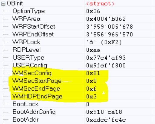

Code is divided into 3 Applictions :
HDP is applied on Bootloader region:
i.e WMHDPEndPage = 3 of Bank 1
Code jumps to secure App from Bootloader App :
Hide Protection access disabled in Secure App.

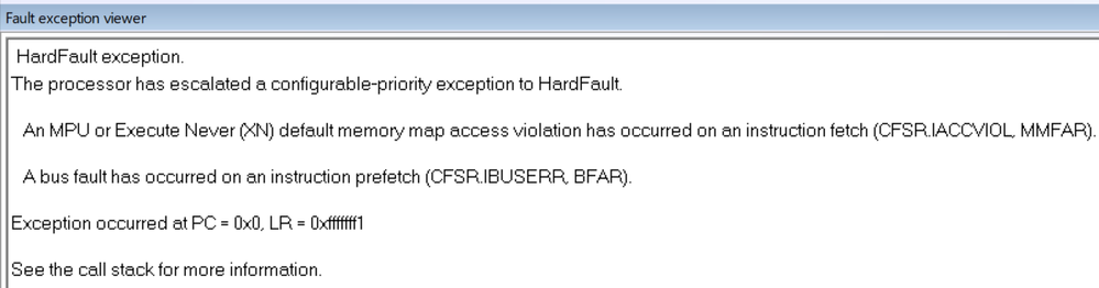

Secure App then jumps to Non-secure App :
here firmware kind of hangs and program counter shows
[PC = 0xefff'fffe]
I have checked HDP by applying it to BANK 2 ,which is working fine.
But when i am applying it to Bank1 (where my code lies) this issue occurs.
I am detailing memory segregation below ,because it seems like jumping to non-secure app is accessing HDP region somehow.
