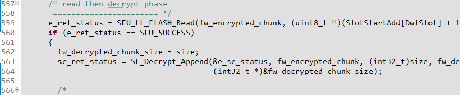

I see APP crash because the APP image is not decrypted but present in encrypted form at __ICFEDIT_SLOT_Active_1_start__

#define SECBOOT_CRYPTO_SCHEME SECBOOT_ECCDSA_WITH_AES128_CTR_SHA256 /*!< Selected Crypto Scheme */I see the firmware from __ICFEDIT_SLOT_Dwl_1_start__ is not decrypted its just copied over to __ICFEDIT_SLOT_Active_1_start__
After call SE_Decrypt_Append both fw_encrypted_chunk and fw_decrypted_chunk_size are same value.

}Which leads to application crash when we transfer control from BL to APP
