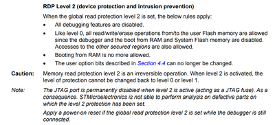

Hi. See RM0468 Reference manual. With RDP Level 2 boot from RAM and System Flash memory are disabled.
If you want to use RDP Level 2, you must write your own loader.

>Has anyone encountered a similar issue or have any suggestions on how to resolve this?
1. There is no "issue" here with the chip. The "issue" is just stupidity and ignorance.
2. To resolve "this" :
A: rtfm. Before setting any RDP level !
B: Replace (now useless chip) and try again.
C: And trust the rm, if read rm :
2024-11-06 3:11 AM - edited 2024-11-06 3:47 AM
