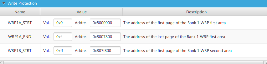

Hi @alister
Thanks for quick response i am using stcubeprogrammer for change RDP level, it change successfully from 1 to 0 but i can't find how to disable WRPs
please find attached image
Thanks,
Arjun
2020-04-17 3:25 AM
Hi @alister
Thanks for your support resolve the issue by changing WRP1A_START and WRP1A_END (WRPxy_START > WRPxy_END = No WRP or unprotected, as mentioned in RM0434 ).

STM32CubeProgrammer isn't intuitive. You'll have to check RM0434 and try to correlate its description of WRP with this GUI.
