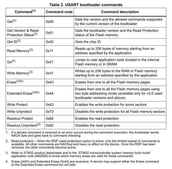

2017-07-14 6:21 AM
Hi, Clive,
thanks for fast answer.
according to the AN3155, USART protocol used in the STM32 bootloader, the bootloader cannot write in FLASH memory if RDP is active.
But there are a couple of commands that keep active (the ones marked with (2) in the table)
My firmware does not communicate with the bootloader (I actually do not know how to do it). Could you expand your idea?
Thanks
