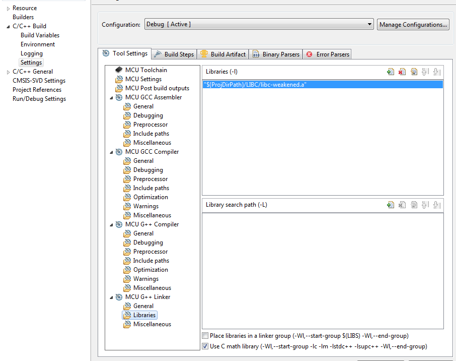

This may have worked in 2019 but it does not appear to work now, Cube IDE v1.10.1.
I have a file called libc-weakened.a (basically the old libc.a but with the mutex symbols weakened using objcopy, so the completely useless empty mutex functions can be replaced with real ones) and can't get it to be recognised. It appears on the LD command line ok, although there is no space after the -l (it shows cannot find -lC:/KDE485/Project1/LIBC/libc-weakened.a) so I tried double quotes and a leading space, still with no luck.
