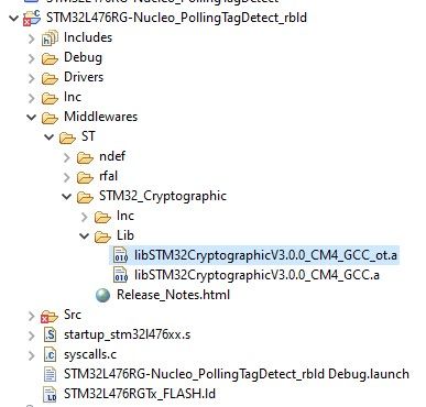

Hello!

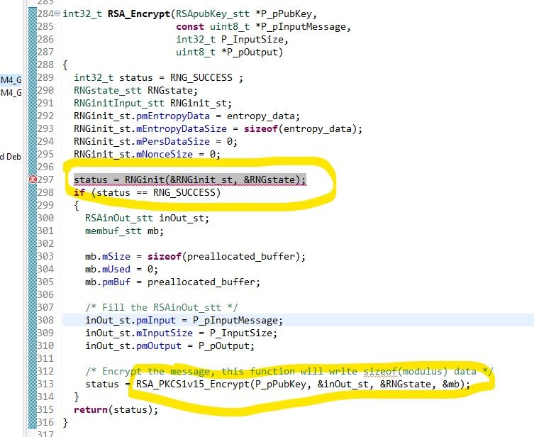

How can i include cryptolyb library .a files into STM32CubeIDE project?
Project doesn't recognize them for now. I put them in source directory in project files catalog.
The following errors occur:
" ../Src/main.c:313: undefined reference to `RSA_PKCS1v15_Encrypt' "
" ../Src/main.c:297: undefined reference to `RNGinit' "

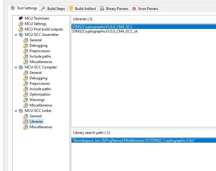

Then i followed instructions from best answer of this topic
And i got another errors:
" c:\st\stm32cubeide_1.4.0\stm32cubeide\plugins\com.st.stm32cube.ide.mcu.externaltools.gnu-tools-for-stm32.9-2020-q2-update.win32_1.5.0.202011040924\tools\arm-none-eabi\bin\ld.exe: error: STM32L476RG-Nucleo_PollingTagDetect_rbld.elf uses VFP register arguments, C:\git_repos\STM32L476RG-Nucleo_PollingTagDetect_rbld\Middlewares\ST\STM32_Cryptographic\Lib\libSTM32CryptographicV3.0.0_CM4_GCC.a(crypto.o) does not "
" :\st\stm32cubeide_1.4.0\stm32cubeide\plugins\com.st.stm32cube.ide.mcu.externaltools.gnu-tools-for-stm32.9-2020-q2-update.win32_1.5.0.202011040924\tools\arm-none-eabi\bin\ld.exe: failed to merge target specific data of file C:\git_repos\STM32L476RG-Nucleo_PollingTagDetect_rbld\Middlewares\ST\STM32_Cryptographic\Lib\libSTM32CryptographicV3.0.0_CM4_GCC.a(crypto.o) "

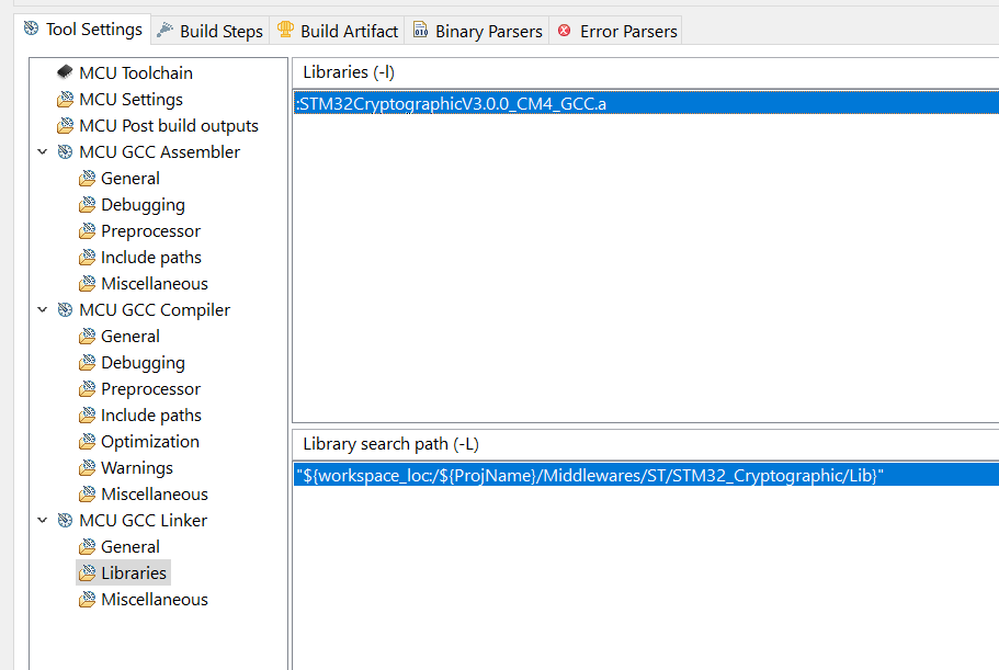

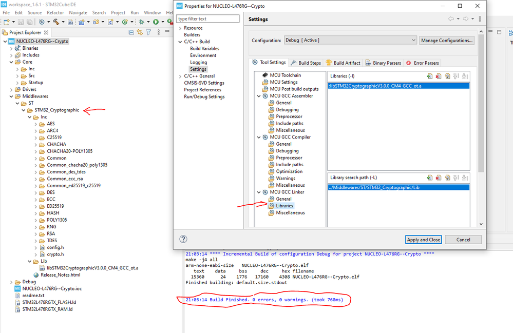

@Wladimir My 2 cents looking at your snashot. If 'Libraries (-l)' area takes care.
1) To add ':' char as first character of your library file
2) To add '.a' libray file extension ... full file name including extension as to be provided
Then possibly if linker process still fail reorder our library files ... GCC is order sensitive here ...
2021-05-07 11:11 AM
Hello Cartu38 OpenDev,
Unfortunately, it didn't help, the error has changed, now can't find the library file. The path to the library file I tried is both absolute and relative to the workspace.
The error is:
" c:\st\stm32cubeide_1.3.0\stm32cubeide\plugins\com.st.stm32cube.ide.mcu.externaltools.gnu-tools-for-stm32.9-2020-q2-update.win32_1.5.0.202011040924\tools\arm-none-eabi\bin\ld.exe: cannot find -l:STM32CryptographicV3.0.0_CM4_GCC.a "

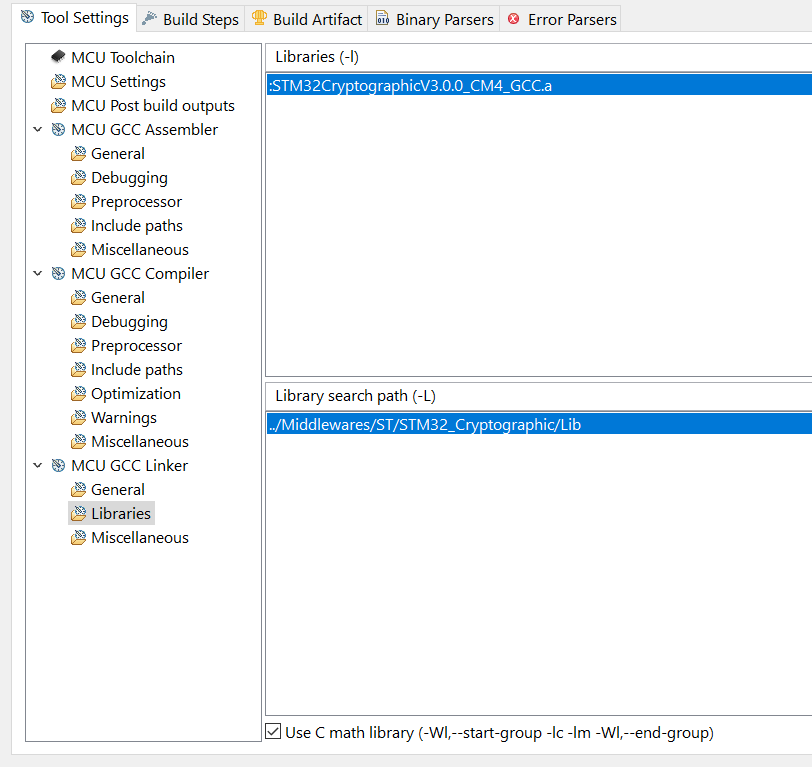

2021-05-07 1:19 PM
Have a try about relative path ... works for me
2021-05-08 12:47 AM
It doesn't help, same error, "can't find -l:STM32CryptographicV3.0.0_CM4_GCC.a"
I entered the path string manually
2021-05-08 12:12 PM
@Wladimir works for me doing hash computation. Please get a try based on attached project (Please just add back to such delivery middlewares part I've removed because such crypto pack content delivery is under special legal terms ... just copy/paste from pack you have)
Note: I rely on STM32CubeIDE 1.6.1
2021-05-08 12:54 PM
Thanks, its builded without errors.
Don't understand what is my issue, i'll try to figure it out.

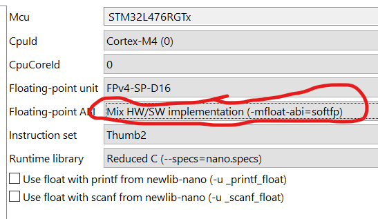

Then i changed floating point settings and it works!)
Have changed from hardware implementation to mixed.
And my project building ok for now!

2021-05-09 12:09 AM
Yep about VFP message such is right setup to do (by the way part of project I've shared to you).
Such message was not primary one you've shared ... first ones were really archive '.a' file access issue. VFP error is coming when '.a' is linked (found so :-))
Happy you're now able to move on ! Well done.
