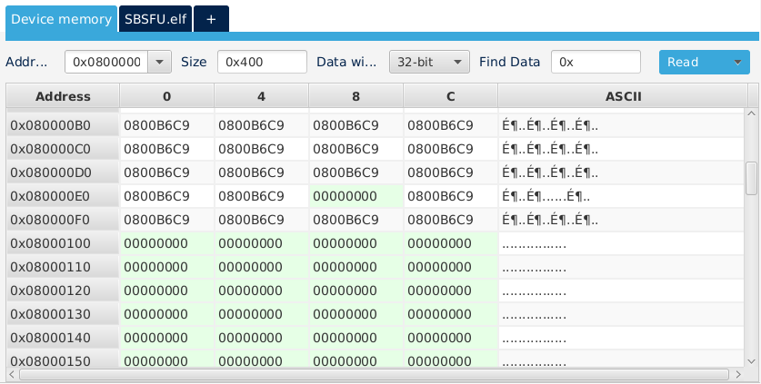

I want to integrate a secure boot and secure software update (SBSFU) on a nucleo H753ZI board.
I downloaded the software from https://www.st.com/en/embedded-software/x-cube-sbsfu.html and followed the steps to compile the three programs (SECore, SBSFU and UserApp) proposed in the "projects" folder using the 1-image version of the SBSFU.
The next step was to program the SBSFU application on the board which I tried to do using STM32CubeProgrammer. However, the program has not been completely installed. The first image below shows the device memory after the introduction of the application and the second image shows what should have been programmed. You can observe that the code abruptly stops after the address 0x08000100 while it should continue.
I suspect that something went wrong when I prepared the board and that the region after 0x08000100 has been mistakenly let as an area protected against writing.
My problem is that since this incomplete code has been inserted inside the board, I can not access it in normal mode using STM32CubeProgrammer, I get a DEV_TARGET_NOT_HALTED error. The only way I can connect to the board is through hot plug mode. But from there I am unable to change any configuration, erase the memory or program anything else on the board.
Is there any way to somehow reset the board, or force it to clean anything that has been programmed on it to put it out from its idle and non-available state?

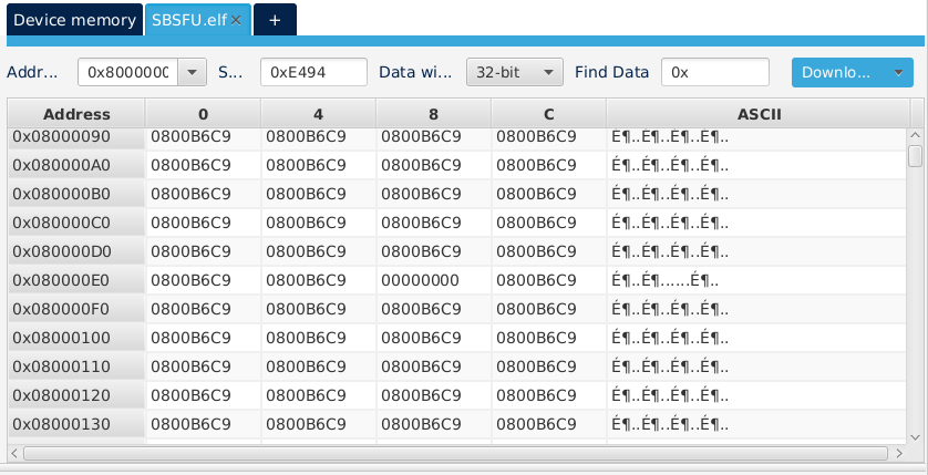

The terms program, install and application may be ambiguous. Anything I say is guessing. Maybe something here will help.
X-CUBE-SBSFU uses the term "install" to describe the decrypting and writing the application into slot#0; the active region. But your first image is of STM32CubeProgrammer with the SBSFU.elf loaded. That's the boot code and not the application. So you've programmed only the SBSFU.elf to flash?
STM32CubeProgrammer would completely program the SBSFU.elf to flash, else it should have thrown an error, or the SBSFU.elf is incomplete and was programmed successfully. Perhaps inspect your link map file or elf file to ascertain if the SBSFU is good/complete. If you didn't output a map file, you might use "objdump.exe -t SBSFU.elf". Look for the addresses and sizes of each of the protections. You will find their symbol names in the code.

I do think the SBSFU has been incompletely loaded. The SBSFU application is 2,6MB large and should have modified the memory of the board from the address 0x08000000 to 0x080050BF. However, in the board memory, only the bytes from address 0x08000000 to 0x080000FF have been modified to the correct values. The rest is set to 0. In the two images I linked to the first post, the first ones displays that only zeros are written beyond 0x080000FF while SBSFU.elf has non-zero values beyond that point.
That address range is 20672 bytes. 2,6MB would be elf file's size and is meaningless.
>I do think the SBSFU has been incompletely loaded. <snip> only the bytes from address 0x08000000 to 0x080000FF have been modified to the correct values.
But later you say " it seems that I am not able to connect to the board through STLINK either".
You must have "connected" to ascertain "only the bytes from address 0x08000000 to 0x080000FF have been modified".

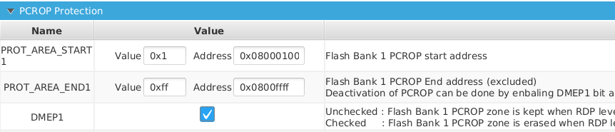

Guessing... PCROP regions are 0x100-byte aligned and possibly STM32CubeProgrammer incorrectly displays 0s for unsuccessful read accesses.
In my second post I said "Look for the addresses and sizes of each of the protections". Inspect the code and its outputs. What protections does your SBSFU configure? What are their addresses/sizes?
PCROP regions are definitely 0x100-byte aligned (see screenshot below).

Your STM32CubeProgrammer screenshot shows PCROP enabled and starting at 0x8000100, and explains the reads from 0x8000100 being incorrect.
For recovery, perhaps try mode "Under Reset" and Reset mode "Hardware reset", connect and then "erase fill chip flash memory". If that doesn't work, you might try individually disabling whatever protections are set in the OBs.
Docs for the STM32CubeProgrammer are at https://www.st.com/content/st_com/en/products/development-tools/software-development-tools/stm32-software-development-tools/stm32-programmers/stm32cubeprog.html#documentation.
If none of the above works, you may find the earlier STM32 ST-LINK Utility tool at https://www.st.com/content/st_com/en/products/development-tools/software-development-tools/stm32-software-development-tools/stm32-programmers/stsw-link004.html.
2021-05-27 3:37 AM
The PCROP should have been disabled and I believe it is the reason behind my problem.
I had tried already to connect with the "Under Reset" mode as I saw in other threads that it could be a solution in some cases. I also retried now, but still with no success. I am also unable to modify any of the OBs when I am in hot plug mode (which is the only mode in which I can connect to the board at the moment).
I also switched back to a Windows distribution to download the earlier ST-LINK Utility tool you suggested. Unfortunately, I obtain the exact same outcomes than with STM32CubeProgrammer. That is (1) I am only able to connect to the board using the hot plug mode, trying to connect in other modes yield an error and (2) in hot plug mode I am unable to perform a full chip erase or to modify any of the OBs.
I ordered a new board as I am out of ideas on how to recover this one and I don't want to take more of your time. I will be more careful with the next board. Your advice in your first reply will definitely help me, I will select it as best.
Thank you a lot for your time and advice.
2021-05-31 6:19 PM
Not sure if you've a problem with SWD reset.
Not sure if STM32CubeProgrammer's mass erase does proper protection removal first.
If you can connect, you might try manually removing protections per RM044 section 4.3.10 FLASH erase operations and other places.
@Remi QUINTIN, you've expertise with STM32CubeProgrammer and option bytes. Could you assist please?
