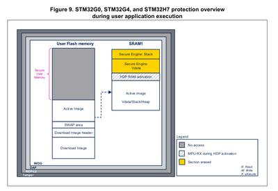

I am now looking at the example of the NUCLEO-H753ZI (2_Images_OSC) and the picture looks different.
This is from the manual UM2262:
So actually, not only the stack but also the SE volatile data cannot be touched. Which in the linker file (and MPU configuration) is actually whopping 12KB DTCM RAM that is being protected.

APPLI_region_RAM_start = __ICFEDIT_SE_region_RAM_end__ + 1;
APPLI_region_RAM_length = __ICFEDIT_SB_region_RAM_end__ - APPLI_region_RAM_start + 1;So as you can see, the application RAM starts after 12KB of SE_region_RAM, and funnily enough, does not include the HDP region?
I am completely lost here on what is going on actually. So much information out there but it's all confusing and insonsistent. User application neither starts at 0x20001100 (as you say), 0x20003100 (as would have made sense here) but 0x20003000 (which does not include the HDP region).
How much of my application memory (and where) do I need to give to the SE?
EDIT: I looked at the non-OSC variant of the code, and it looks different again. Closer to your image above, but still HDP memory is not included and overwritten by application.
EDIT2: Sorry I have to vent somewhere, the SBSFU is close to a catastrophy, I guess there is a reason it is considered legacy now, I imagine its umaintainable at STM's side. I am running this on a Linux PC and there is all kinds of issues. Shell scripts that only start to work, once you convert the windows file endings. Prebuild-scripts that use python3 (good) and postbuild scripts that use python2 (what? why?). It is a total mess :( This needs to run on a CI/CD server, so yeah.

@Jocelyn RICARD wrote:Regarding the usage of the RAM used by SBSFU and SE, except if you used the image validation feature, I don't see any reason why you couldn't use it. Only possible protection is the MPU and if MPU is still active when jumping into application (sorry I don't remember of this point), this it is easy to reconfigure it.
Use what exactly? See, this is the kind of inconsistent information that you can find everywhere. I really don't know for sure, if my application needs to reserve the first 4KB 4KB+256B or 12KB or 12KB+256B of DTCM RAM. Obviously I can find it out by just testing (or taking a week of time to analyze all the ins and outs of the SBSFU and SE), but that really isn't a preferred way when dealing with secure software, since one mistake could mean the difference between secure and insecure.

Now regarding DTCM usage. As I said you can reuse all of it. There is no specific RAM protection on STM32H753
If you enable firmware validation, the firmware image state is stored at end of DTCM:
__ICFEDIT_SB_region_RAM_end__ = 0x2001FFEF;
/* Shared RAM for Image State Handling */
__ICFEDIT_SB_FWIMG_STATE_region_RAM_start__ = __ICFEDIT_SB_region_RAM_end__ + 1;
__ICFEDIT_SB_FWIMG_STATE_region_RAM_end__ = 0x2001FFFF;
So, in such case, you should keep it in your linker file so that secureboot can get the information.
