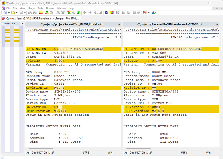

2024-11-13 9:06 AM
Thank you @Jocelyn RICARD I compared the outputs, it appears all the option bytes are the same, only the boards have some differences (left is mine, and right is yours).
2024-11-13 9:51 AM
Hello @Thatseasy ,
OK so the issue is the board. SFSP 0.1.1 which is the version of the system flash secure part is very old and will not work.
To get Secure Manager work you have to get a new DK board.
Best regards
Jocelyn

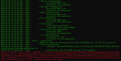

2025-01-30 1:03 PM
Hi Jocelyn,
I have similar issue on the new H5-DK board with SM installation, followed online instructions (Security:How to start with Secure Manager default configuration on STM32H5 - stm32mcu) step-by-step, but failed at sfi secure installation at Step 2: Installation.
The provisioning.log file is also attached, the log file says it failed at launch RSSe.
What can I try to get this DK board working?
Any help is apprecaited.
2025-01-31 1:38 AM
Hello @ChangeToH5 ,
issue comes from the version of RSSe that you are using:
C:\github\STM32Cube_FW_H5_V1.4.0\Projects\STM32H573I-DK\ROT_Provisioning\SM\Binary\RSSe\H5\enc_signed_RSSe_SFI_STM32H5_2M_v2.0.1.0.bin
Version should be
STM32Cube_FW_H5_V1.4.0\Projects\STM32H573I-DK\ROT_Provisioning\SM\Binary\enc_signed_RSSe_SFI_H5-2M_v3.0.0.0.bin
Could you please download SEC-M H5 v1.2.1 and check again?
Also, you may update STM32CubeProgrammer from v1.17 to V2.18 but shouldn't be an issue.
Best regards
Jocelyn
2025-01-31 8:28 AM
Thank you @Jocelyn RICARD for the response.
Initially I did have X-Cube-SEC-M-H5_V1.2.1 by following "How to start with Secure Manager (customized configuration) on STM32H5" which recommends X-Cube-SEC-M-H5_V1.2.1, I tried it without change any configuration but unsuccessful for installation. So I realized I should do "How to start with Secure Manager default configuration on STM32H5" first, which recommends X-Cube-SEC-M-H5_V1.2.0, that's why I changed to use enc_signed_RSSe_SFI_STM32H5_2M_v2.0.1.0.bin instead of enc_signed_RSSe_SFI_H5-2M_v3.0.0.0.bin.
Could it be possibly messed up by changing RSSe versions when failed at installation step of "How to start with Secure Manager (customized configuration) on STM32H5"?
FYI. Later yesterday, I did a full chip erase by STM32CubeProgrammer 2.17.0 tool, then without any settings change, I was able to run "python provisioning.py --sfi-flash -a" successfully, do you know why? (just curious what could be possibly the reasons that fixed my issue).
