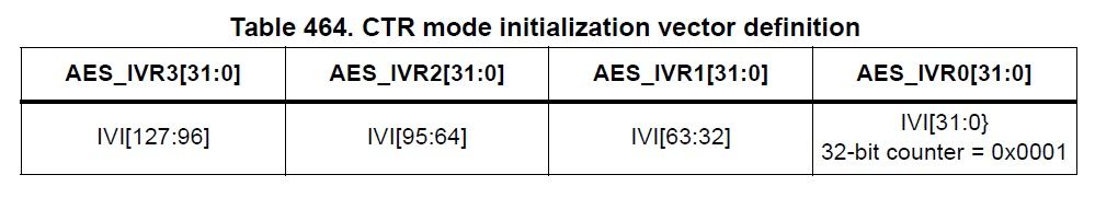

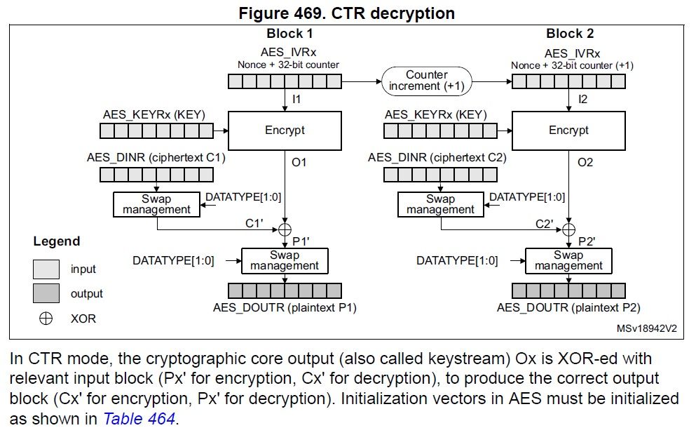

@Jocelyn RICARD does the library provide any "Swap Management" on the KEY and IV? Or is getting the KEY/IV WORD's into BIG ENDIAN all on the user?
https://github.com/cturvey/RandomNinjaChef/blob/main/STM32U5_AES_128_CTR.c
I might have to try harder with the padding, because it works when I don't bother with it, but the XOR pattern is coming from the AES crypt of the IV, in a stateful 16-byte line, incrementing the count, not the source data in the plain text (encrypt / decrypt being identical / symmetrical in nature in CTR)
2024-10-18 8:55 AM
Hello @Tesla DeLorean ,
For first point, I guess you already know the answer. This key in put as a stream of bytes is not provided in the HAL.
I can see 2 solutions for that.
1) Just add a code to reverse the key and iv at input:
uint32_t buildKey[4] ;
uint32_t buildIv[4] ;
for(uint32_t i=0; i<4; i++)
buildKey[i]= __REV(*(uint32_t*)&key[i*4]);
buildIv[i]=__REV(*(uint32_t *)&iv[i*4]);
2) Do this directly in CRYP_SetKey and in CRYP_SetIV but changing HAL may not be a good idea...
Regarding your second point, I don' catch exactly what you want. Could you please detail ?
Thank you
Best regards
Jocelyn
2024-10-18 9:44 AM - edited 2024-10-18 10:28 AM
Just that I find the libraries some what quixotic and inconsistent. It makes cross-platform use and demonstration more frustrating than necessary. I'm not a huge fan of "online calculators" as there's a lot of variables and moving parts, but people do use them to test/validate what they're doing, and I have to work with real-world usage of the technologies, and the rigidity of HW implementations with different sets of expectations. This and PKA are fraught with issues of interpretations and expectations, and zero tolerance for any mismatch.
In terms of when things get swapped/shuffled, that a KEY/IV that's literally in the correct byte order for the large endian mode/representation, in a form data crosses the wire, writes to a file, that that's not the acceptable form, and the library code doesn't have a flag to move it to a form the engine demands. Thank goodness the data portion has a swap-management.
The documentation/library could do with some illustration of exactly what "swap management" does at a bit/byte/word level, it's applicability to data and key/iv patterns, and inconsistency there. RM0456, not sure if the is better illustrations elsewhere.

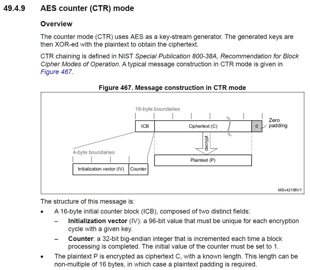

My second observation regards zero pad, I'd really like to use the input data in-situ, not move it to a secondary buffer, the benefit of CTR is that it needs only XOR the content, it's not doing bitswitching/crypting over the entire 128-bit / 16-byte line.
The unit doesn't look to need padding, the unit outputs 32-bit words, so there's slight overspill on the data return buffer, but the bytes that need encrypting/decrypting are done so correctly. The last line on my pattern has 6-bytes, I get 8-bytes touched by the library, the 6 I want, and it adds 2 junk bytes, I can live with that, but I think the "needs padding" observation in the docs overstates the actual need/requirement. Perhaps it impacts other uses?
