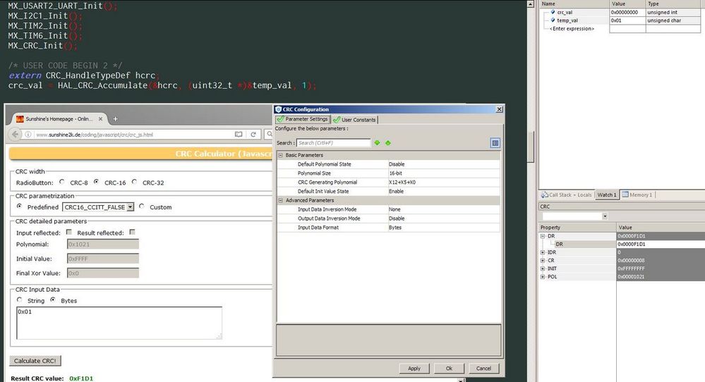

Running 4.15 and as a programmer I really don't need this Xa+Xb rubbish. Can we just have a decimal (or preferably) an hex field?
If it is going to have something clever like this then at least make sure it works. There are just so many things wrong with the implementation.The CRC16 CCITT poly is x16+x15+x5+1 but according to the help, for a 16 bit poly the highest value must be LESS than 16. So I tried entering x15+x14+x4+1 (and without the +1) thinking that the bits were numbered differently but still no go. In fact it doesn't accept any values :( #crc #stm32cubemx #polynomial2016-08-22 3:26 AM
Hi frackers,
I have submitted your request to our CubeMx team. Meanwhile, you can follow the example ''CRC_UserDefinedPolynomial'' in theat this path: STM32Cube_FW_F3_V1.6.0\Projects\STM32303C_EVAL\Examples\CRC\CRC_UserDefinedPolynomial
This example example exaplain how to change the� GeneratingPolynomial� parameter by a defined macro. -Hannibal-2016-08-30 4:47 AM
Hello. You can use X12+X5+X0 for CRC-16-CCITT (x^16+x^12+x^5+1) because:
''The polynominals present as a binary representation, with the high order bit inferred as it's always one and just beyond the scope of the register. So 0x07 -> 0x107 -> x^8 + x^2 + x^1 + 1'' Please see: STe2eCommunities > Microcontrollers > STM32 Software Tools and Firmware > ARM SPI CRC Definition Polynomial Structure.2016-11-07 5:03 AM
