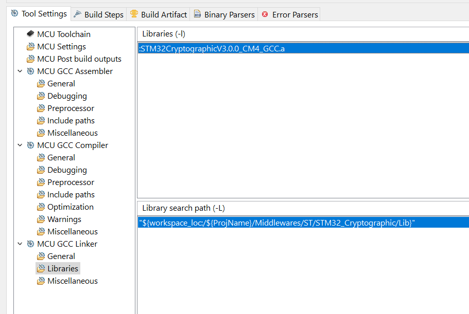

Hello Jocelyn RICARD,
Unfortunately, it didn't help, the error has changed, now can't find the library file. The path to the library file I tried is both absolute and relative to the workspace.
The error is:
" c:\st\stm32cubeide_1.3.0\stm32cubeide\plugins\com.st.stm32cube.ide.mcu.externaltools.gnu-tools-for-stm32.9-2020-q2-update.win32_1.5.0.202011040924\tools\arm-none-eabi\bin\ld.exe: cannot find -l:STM32CryptographicV3.0.0_CM4_GCC.a "
Best regards, Vladimir
2021-05-10 10:46 AM
Hello Wladimir,
the issue could be related to too long path.
Could you try moving your project in a directory close to root ?
Otherwise, you could get the last cryptolib patch
The STM32CubeIDE is supported there for the recent STM32 families
Best regards
Jocelyn
2021-05-10 12:52 PM
Hello, Jocelyn RICARD,
Found solution of my problem in this topic, check out my latest post:
