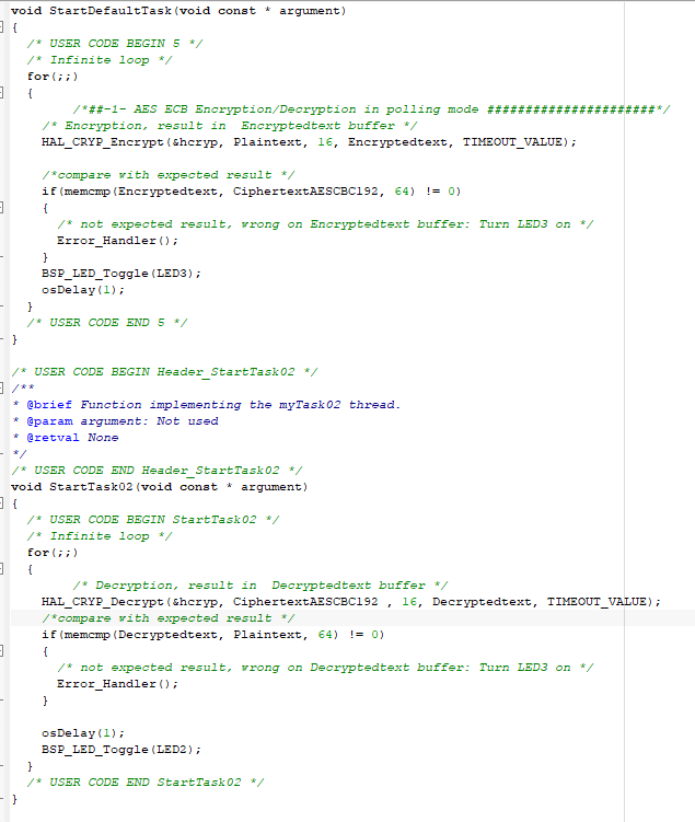

Attached a main.c file running STM32H7B3I-DK as the nucleo-h753ZI is not available for me. It is easy to migrate it to nucleo-h753ZI.
The freeRTOS project contains 2 Tasks, one for encrypt and the second for Decrypt. The default settings of FreeRTOS are used.
To reuse the project, you can generate a new one for nucleo-h753ZI by CubeMx enabling the TIM6 as source of Tick. Then use this main.c file instead of the generated one.

thank you for your reply. I found out that there is some relation to data width you use for crypto. When I was trying 8bit data, it was not working. When I switched to 32bit, it is working fine with Timer 6 as timebase source. I have no idea why.
My original test was with default Cube MX project for H753ZI, no MPU, CMSIS V2, 1 task in freertos and 1msec period.
I was able to continue with 32 bit data, so it is not stop condition. Since you used 16bit, maybe the problem is only with 8bit data width.
Martin
