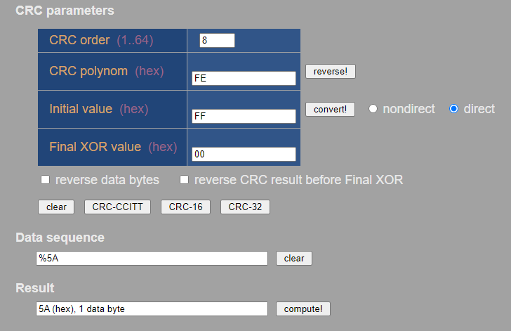

Hi JW,
Thanks for your reply.
It's here: http://www.zorc.breitbandkatze.de/crc.html
It does have a "final XOR" configuration but unfortunately I put a "0" there. See below:
I did some further investigation and seems if the LSB of the polynomial is "0" (in this case 0xFE = 8b11111110), the L073's CRC adds a final XOR with 0xFF to the result.
