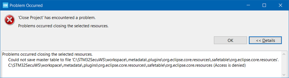

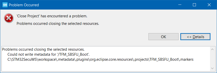

Now I have just come back to the STM32Cube IDE; it started up with the last 2 workshop projects still open (as would be expected). But when I tried to close these projects, I got the following errors:

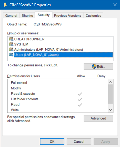

It seems that the whole workshop folder tree was installed with only 'Read' access for Users:

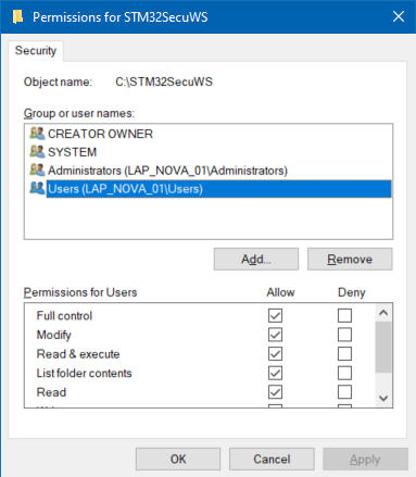

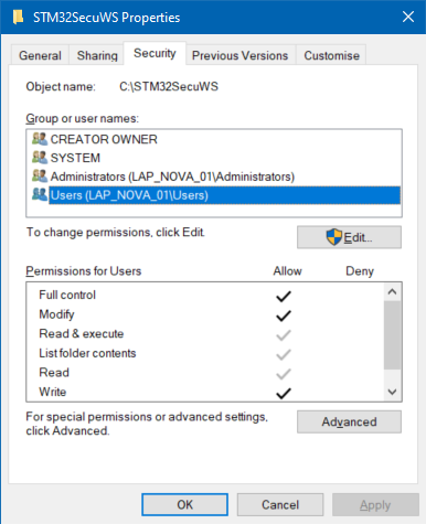

Giving 'Full Control' stopped the problems:
Hopefully this will be of help if anyone else is having the same problem.

Hello Andrew,
After creating any directory you get this behavior. I mean : creator owner can modify whereas Users can only read.
So, I guess you didn't use the same user account between package installation and usage.
Is that the case?

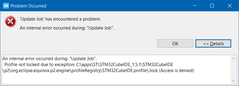

I've just downloaded the latest STM32CubeIDE, and installed it.
Now I'm getting the same again:
Again: downloaded, extracted, and installed all with the same login.
