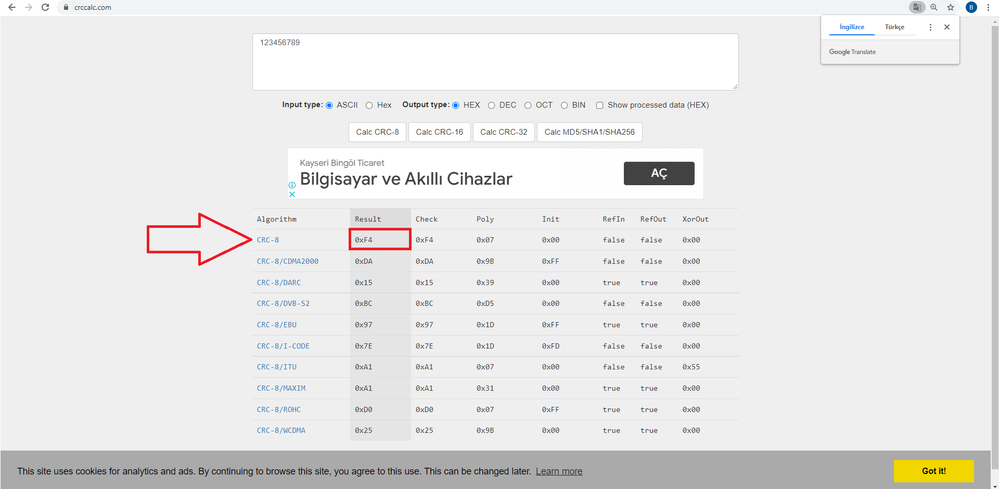

When I calculate via http://crccalc.com, input: 171D00, result is 0A (this is ok)
I couldn't get this result when I calculated it with mcu.
