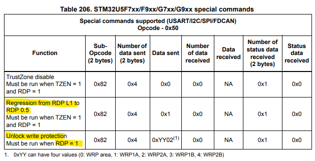

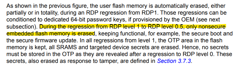

If I enable RDP level 1 and WRP. Could system memory bootloader disable WRP and then regress RDP to level 0.5 by command?
After regressing RDP to level 0.5, the non secure area would be erased. Then it could perform the firmware upgrade process I mentioned above.
And then enable WRP and restore RDP level by change option byte in secure boot/application.
If it is not possible, could you provide an firmware upgrade example (SBSFU?) or application notes that using single slot for STM32U5?
